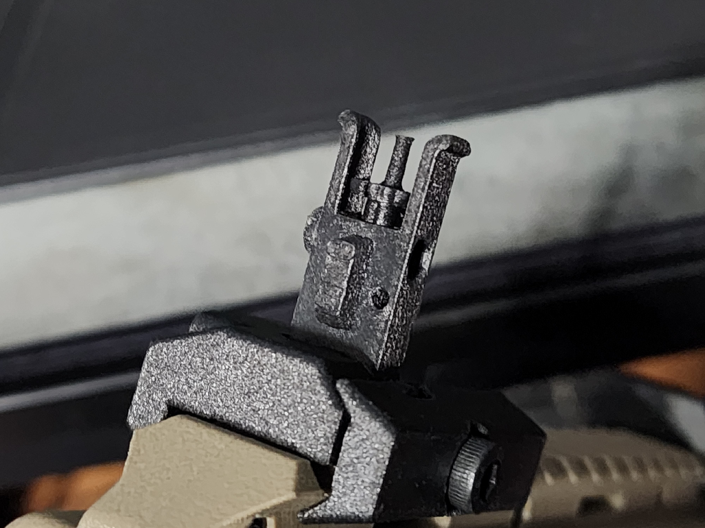

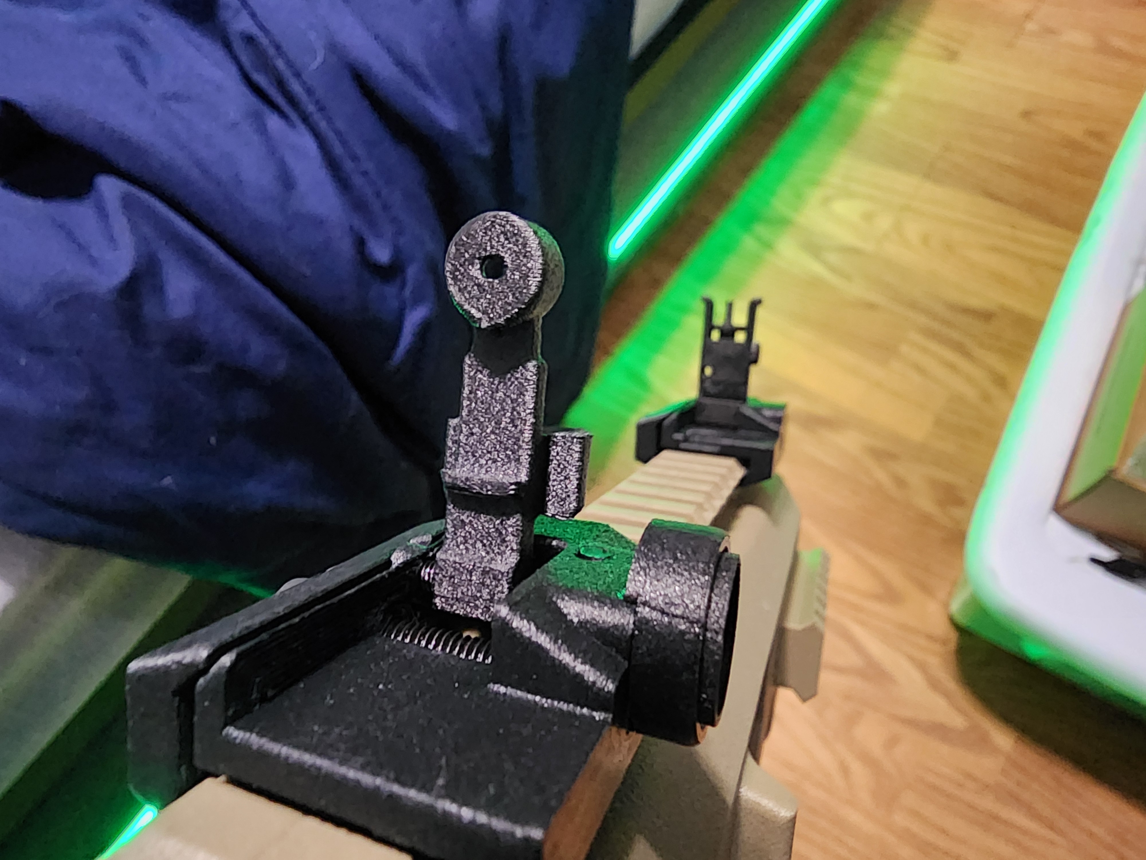

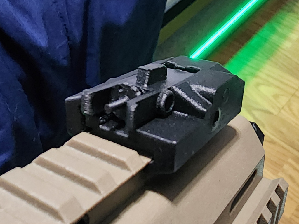

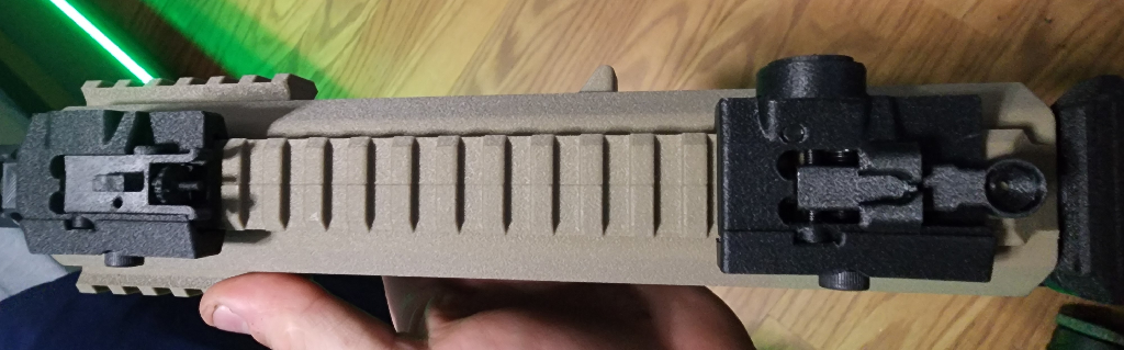

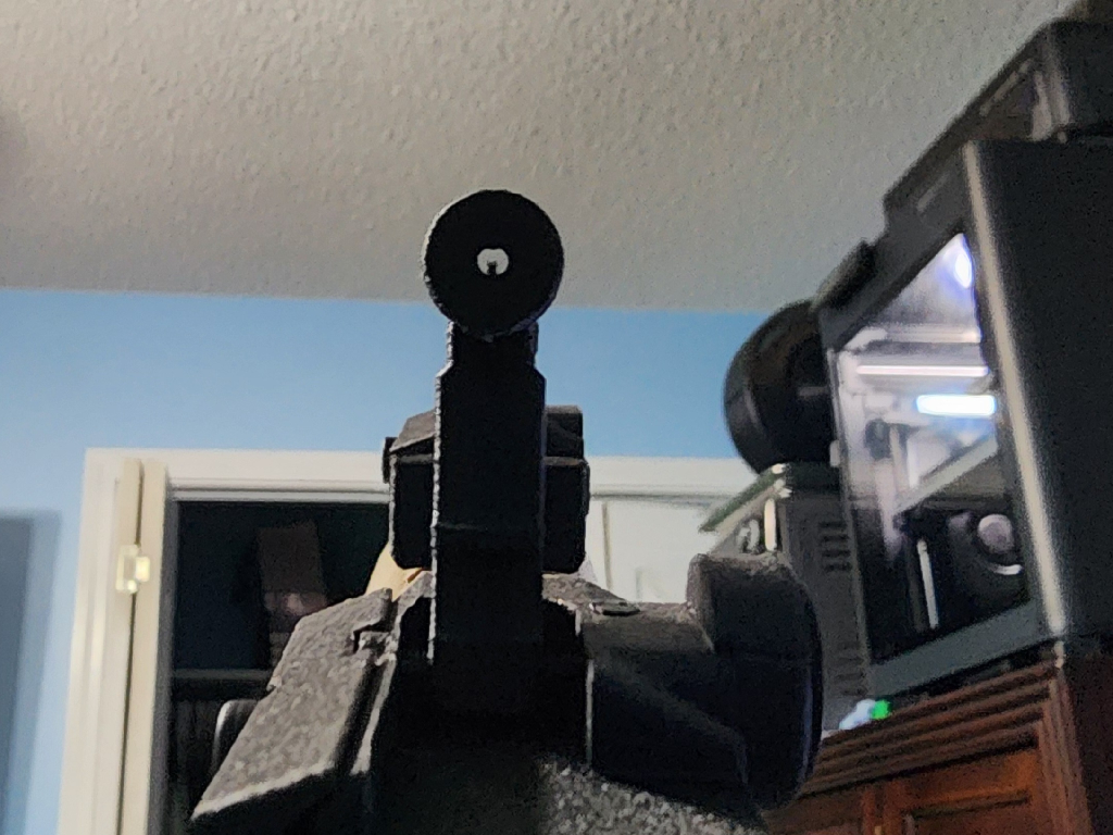

    Printed MP7 Iron Sights for under $5
    Began working on some MP7 iron sights last night, its taken all day making minor tweaks but I've got the first functional set made for roughly $5.
    Fully functional windage and elevation adjustments as per the real steel. There's a hole in the front sight for a setscrew to adjust elevation when folded. The front sight post can be adjusted up and down for elevation by screwing it in and out, theres a printed detent that makes it tight enough to never move unless you purposely adjust it (shes on

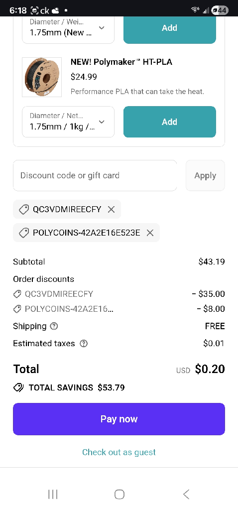

  • Thankfully and big props to polymaker, they gave me a coupon code to get another spool. I had $8 in credits to use and with the code I was able to order another 2 rolls for a whopping $0.20!

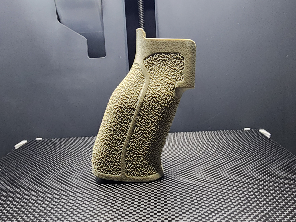

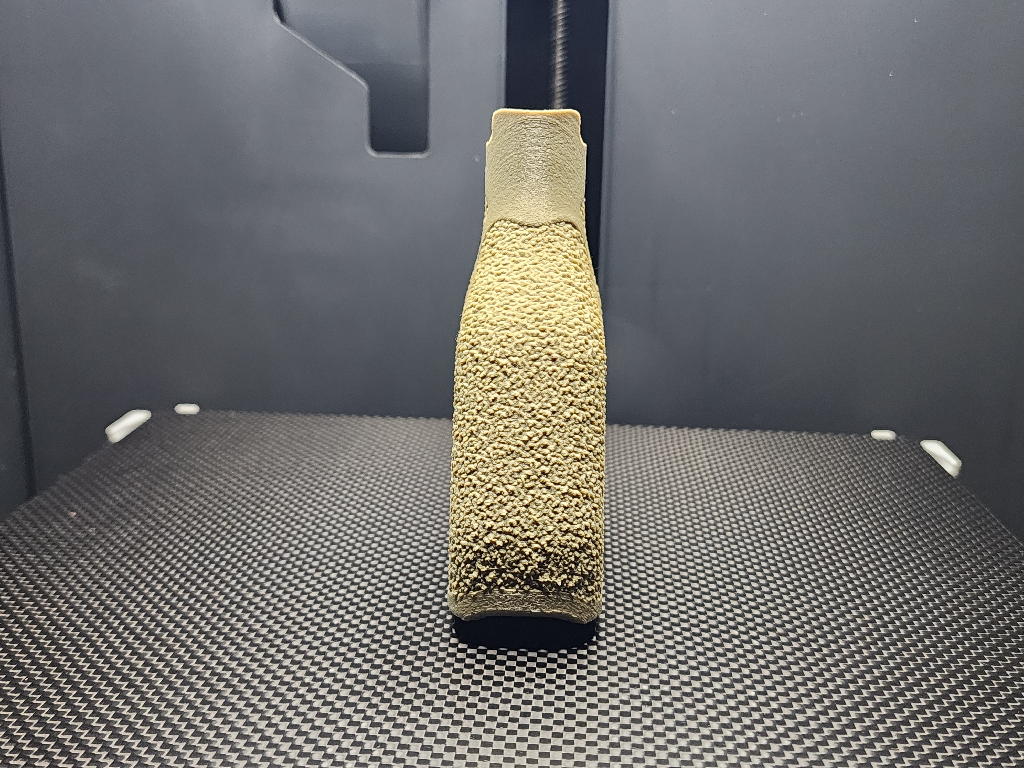

    First print with Siraya Tech PET-GF
    First print after calibration using Siraya Tech PET-GF in FDE. Print came out nice and is surprisingly strong at only 25% gyroid infill. I used 8 walls with 6 top/bottom layers. Printed at 300C nozzle with 80C bed on a Bambu P1S using a Darkmoon CFX build plate and printing from a 60C dryer. 0.4mm nozzle at 0.16mm layer height. One nice benefit to this filament is it comes completely dry and ready to

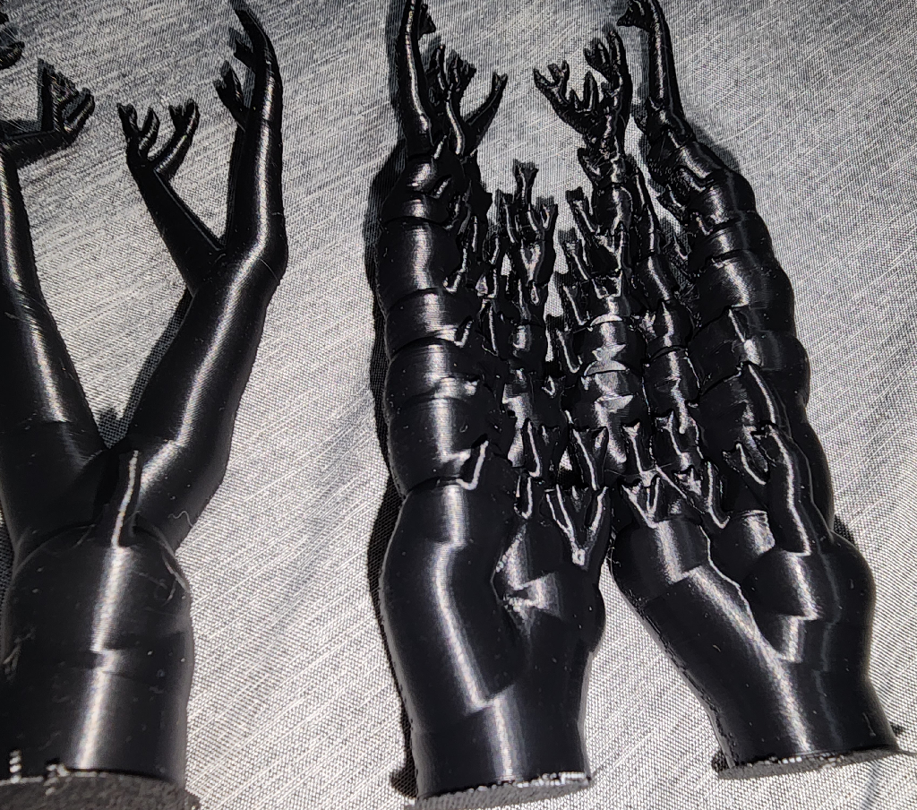

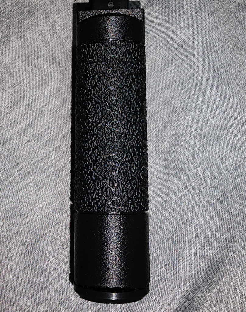

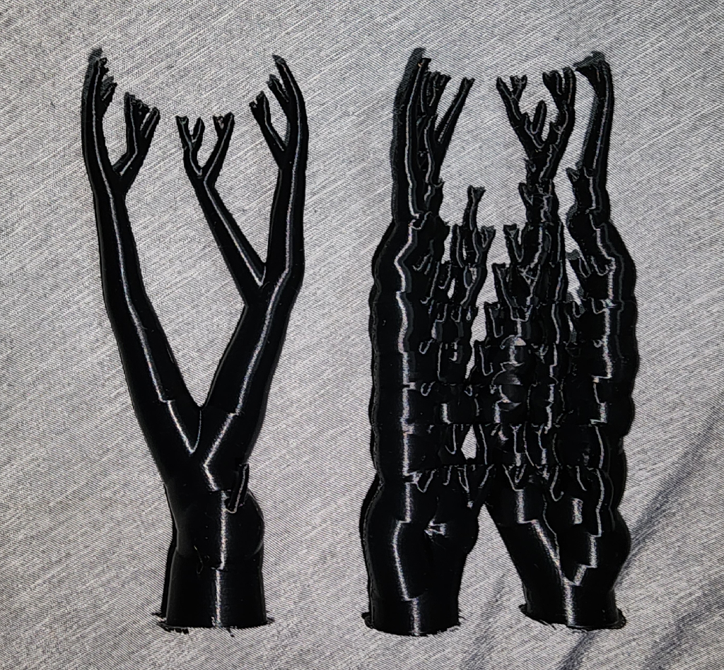

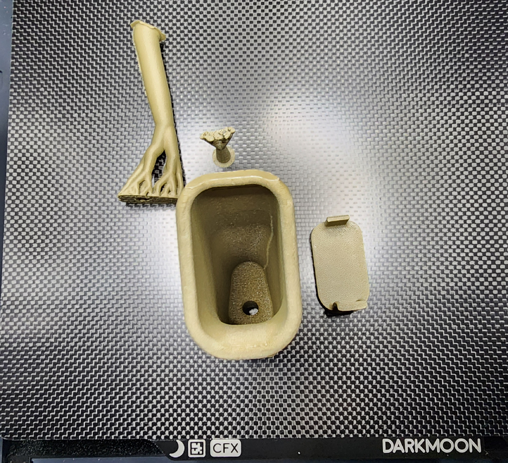

    Finally got my support settings dialed in - TX22 Boomtube 22 Mag Extension
    This is in Overture PLA Pro using 0.15mm layer height with a 0.1 fuzzy texture and 99% infill. It's 300BLKFDE's PA6-CF settings with a PLA Pro profile and modified support settings.
    17hr print time, yes PLA can be printed much faster, but the increase in quality is worth it in my opinion.
    Correction: It's the BoomTube 22 - https://odysee.com/@the_fly1ng_v1k1ng:9/BoomTube-22:5
