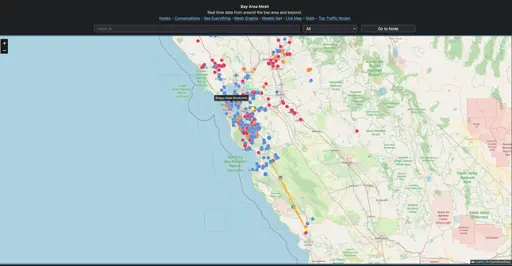

    Oh yeah central valley hits it all the time with 7 hops. Its awesome. Wish the hop system worked more like meshcore but it is what it is.

      What are your primary direct connections? Assuming yuba and sutter buttes?
