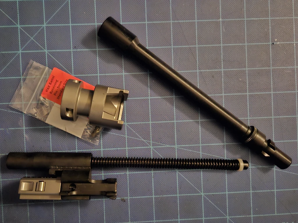

  • Oh no I seem to have gotten 9mm parts. What ever shall I do with them
