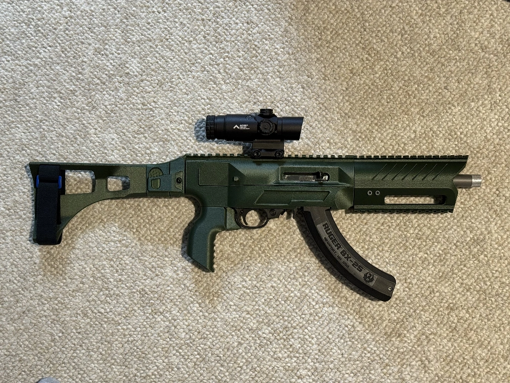

  • It was a surprisingly easy build. The biggest challenge for me is always arranging things on an A1 mini’s build plate. The optic cost more than the build, but I really like the PA GLx2 optics. Combined, it cost about the amount of a Ruger Charger for just the gun itself though.
    The Wisp is quite a bit more complicated, as the guide is rather brief on how to actually assemble some parts. But I’m still printing parts for the stock and awaiting some more parts to fully assemble.

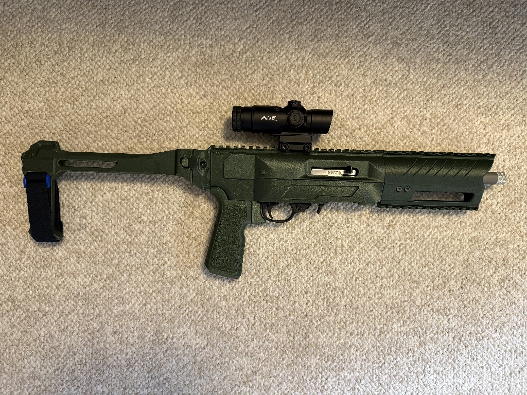

  • Here is the Remix 3 on an 8” BA barrel. I went with a different brace, which was the longest I could fit on an A1 Mini…and I had to trim the pic rail on the lower to get it to fit. But it provides an extra inch length over the better looking Sauerkraut (photo also included).
