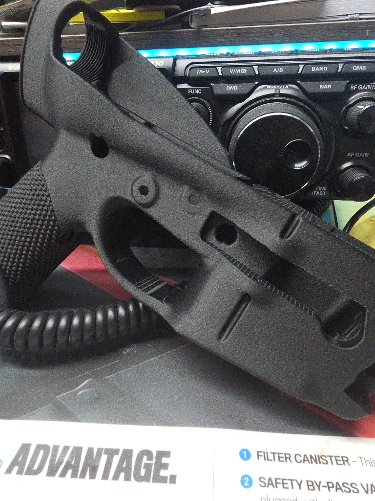

  • IIRC the holes need to be drilled too the size of the pins. Ill bring home my good drill bits.
  • Im impressed. It's fibron. I'll order some salt and let it hang out in its naked glory.
  • flower salt not sure of what that is,? I was going too anneal in the air firer, same one for drying PA.
    Edit, is there a need too add moisture into the print afterwards? Im still a bit new to PACF
    ok, did some reading. so can i get away with a dish of regular table salt. then 100c for a whopping 16 hrs? damn.

    I have a hoffman sl9 running in the bambu as I type. Whats some preferred tips and tricks for annealing. Ive heard the obvious temp and time. Do I leave the supports on while its cooking? thanks.
