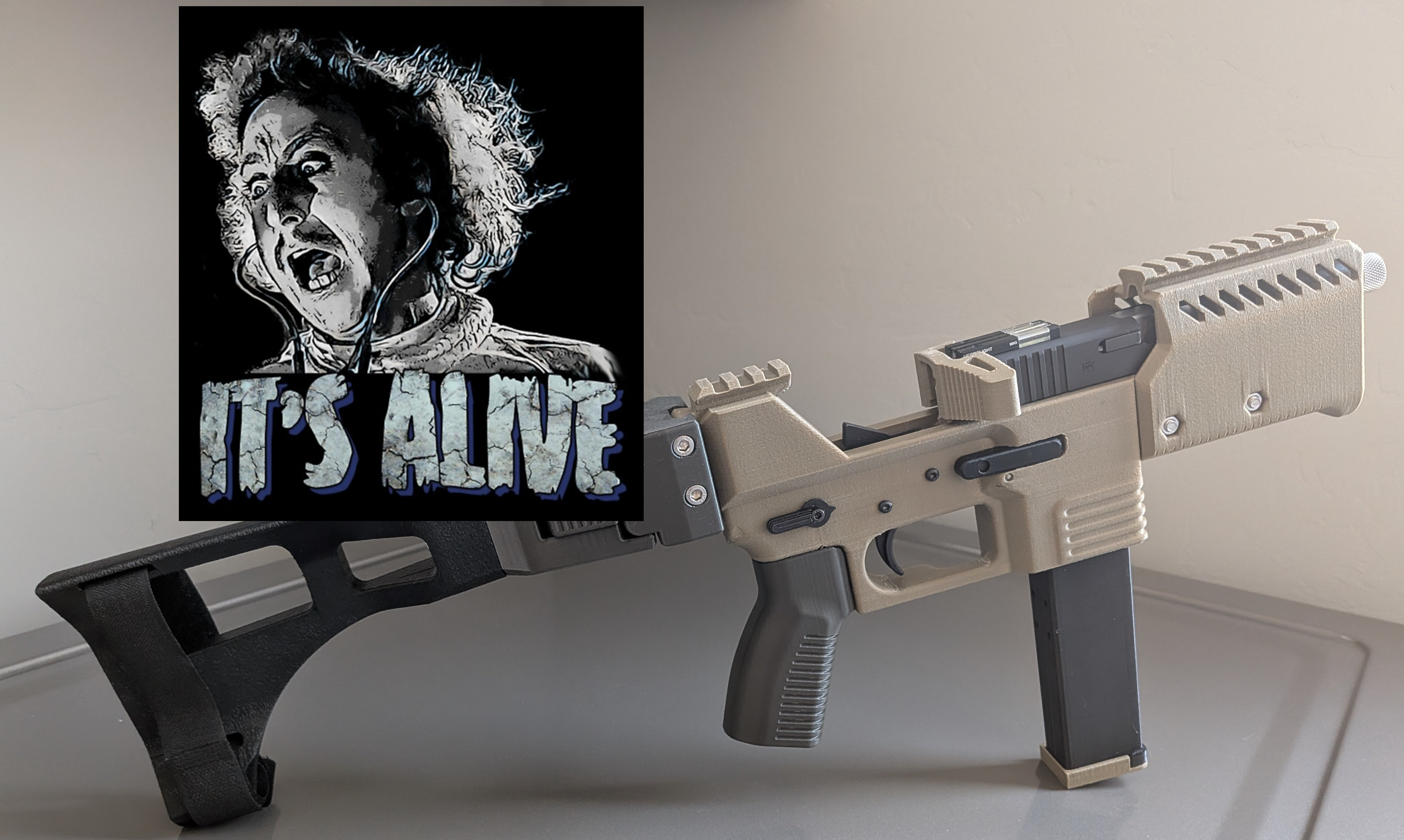

    With Unseen Killer's help, I was able to determine that my Franken 9 problems were entirely due to using printed Sten mags. There was a different problem that affects only milsurp mags, but that's fixed in UK's latest drop. If you're using milsurp mags, print the latest frame and you should be good to go.
    The problem with printed mags is that the dimensions deviate significantly from production magazine drawings. Every design I checked was wider at the feed lips and flared more steeply than specs call for. Most are also about 1mm shorter font-to-back. As a result, they won't seat deep enough to reach the mag catch or feed correctly (or at all). To be clear, there's nothing the Franken 9 can do to fix this -- the incompatibility is with the Glock slide itself.
    I didn't want to print new mags just for this build, but curiosity got the best of me. I remixed a "spec-ish" version of the DMB Sten v1.1 and squirted a test print in PLA Pro. With that the Franken 9 is able to feed 100% reli

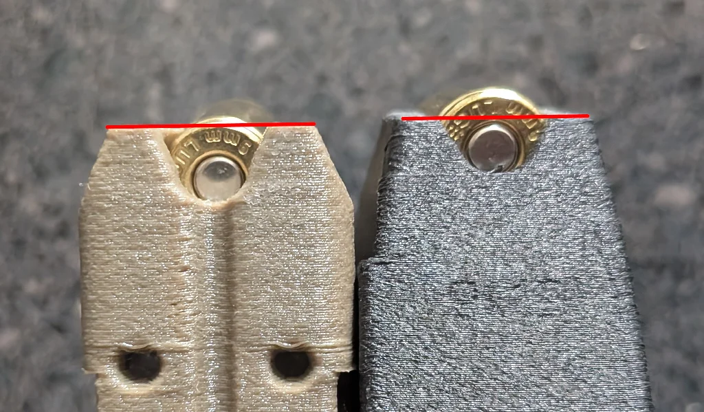

  • You're close. It's not an easy problem to describe. Here's a photo that might explain it better (DMB Sten left, DMB Glock right):
    This is with the DMB Sten mag, but the UK and DB9 are all very similar. I could probably mod the mag to make it work, but I think remixing with a Glock magwell would be a more robust solution.

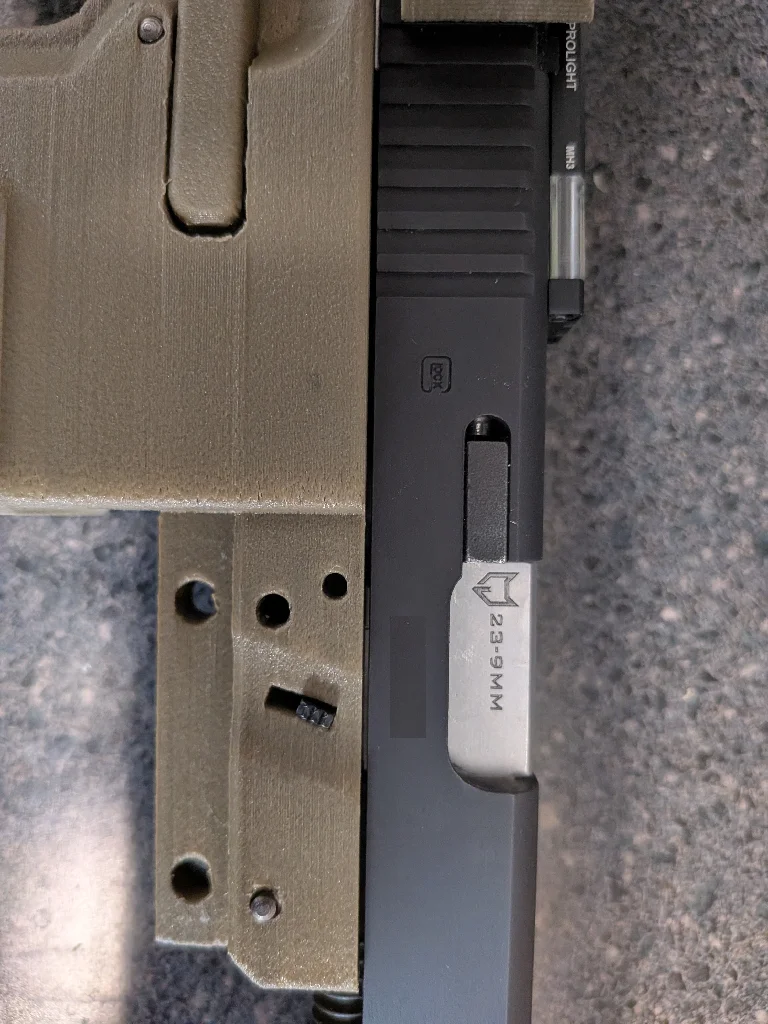

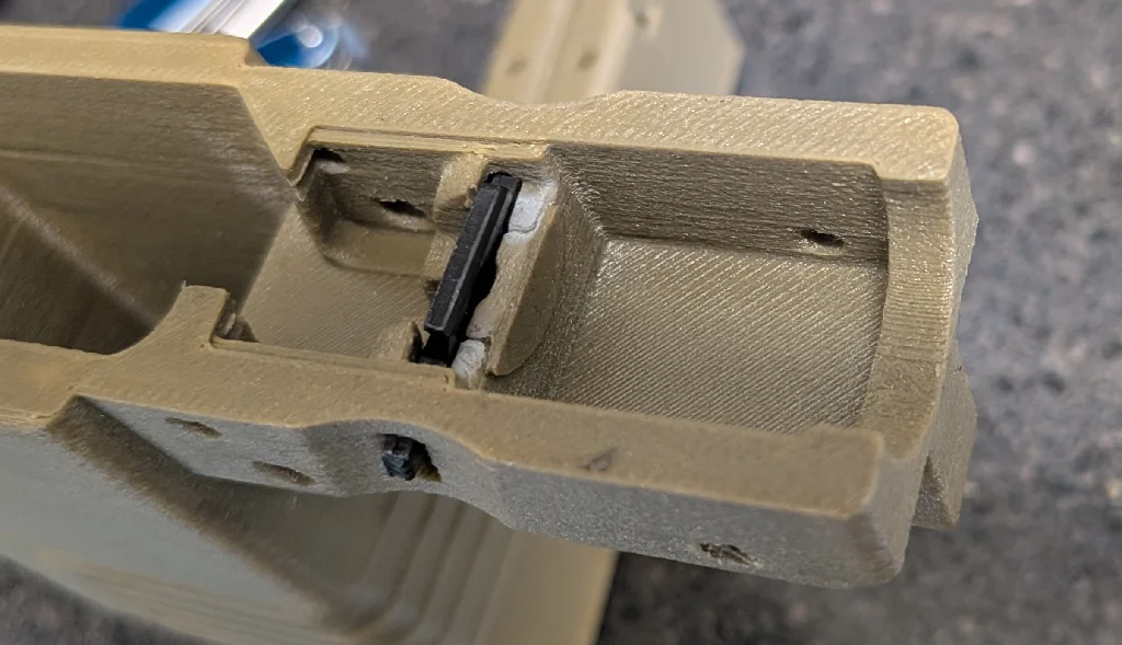

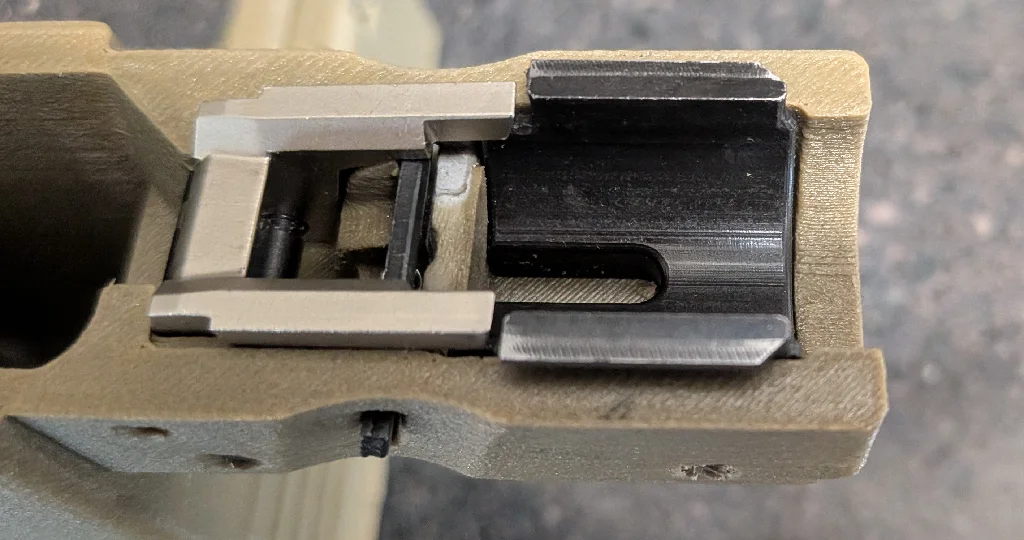

    Front rail pocket:
    Front rail pocket w/ rail:
    Slide on:
    I should mention this is the pre-fix frame. I just printed a small part to fill the gap in the guide rod stop and glued it in place so I could finish function testing before I re-printed.

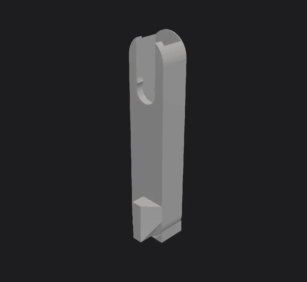

  • I've been able to get remixed magazines to retain and feed dummy rounds, but that's just not a good solution. The last thing anyone needs is yet another "almost Sten" mag that won't work in anything else.
    Instead, I came up with a re-designed magazine catch that should work with standard printed and/or surplus mags. I have a DMB Sten mag on the printer now. I'll fine tune the mag catch dimensions with that and then post the STL (hopefully tomorrow) for anyone that wants to try it.
