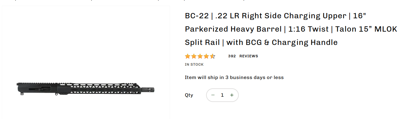

Does anyone know of any builds I can use this BC-22 BCG/Upper? I have only seen Kaewon’s upper or BCA 9mm Builds. Thanks guys!
