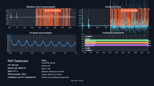

As some of y’all may have noticed - there is a new @ROFBot@fosscad.io - I’m developing it myself.
Will eventually open source. But it’s a bit of a buggy mess right now.
Please be patient with the bot, and take results with a grain of salt for now.
Attached is an image you would get commented on your post.
I’m playing around with the backend to use different strategies.
There is this GUI that u/schlarpc made: https://schlarpc.github.io/rof-gui/
It uses similar envelope detection, but a manual fixed threshold. It also reports the whole RPM of the clip along with mean/median burst rates. The downside to this is it caps out at a minimum spacing of 50ms per shot (~1200 RPM)
We’re taking a different approach, attempting to comb through peaks and find shot audio, while filtering out echos/ejection noise.
It’s buggy. But i’ve seen median error rates as low as 2% over my test data, but when it fails it fails hard.
Long story short, bot reply might be full of crap, but all the data gathering helps!

    Doing some major refactoring anyways.
    This is our current configs results over the test suite.
    Clip coverage: 37 clips across 35 RPM buckets
    • Average percent error: -0.01%
    • Std dev percent error: 16.15%
    • Average absolute percent error: 9.22%
    • Median absolute percent error: 3.01%
    • Max absolute percent error: 47.65%
