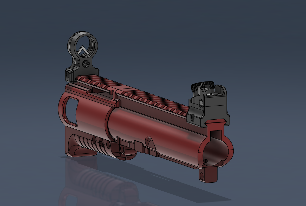

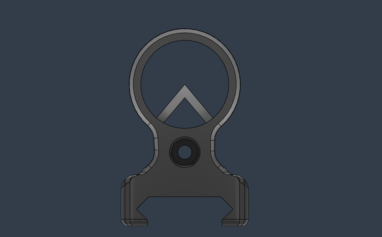

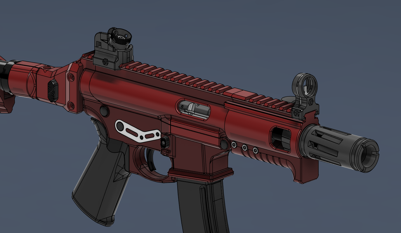

Side project I’m working on. Trying to keep them authentic looking. Front sight is finished. The post is SCS-able and I’ve made a blitzkrieg style alternate post as well. Commercially available posts are not interchangeable as I had to move the M3 slot down a few mm.
The rear sight poses more of a challenge. Drum is functional and is basically the same design that the MP22 build uses but I’m still figuring out how to make windage adjustable as there is not a lot of material there to work with. HK sells the bolts individually for these adjustments but $5 each. May try some heat-serts and some set screws to achieve the same result while not forking over $20 minimum for two bolts. For now I’m using a fixed version of the rear sight with the rotating drum.

      I’ve taken a look at those. It looks like only the front sight is adjustable, so its completely opposite to what I am making.

    Looks nice, I’ve always been a fan of these sights.
    The T.I.T.S. iron sights have a windage adjustment that uses an m3 or 4 volt, captured nut, and a locknut. I’ve used this set up in a different set of sights and it worked well and didn’t require special hardware. Perhaps singing similar could be adapted.
    How’d you get elevation on the drum?
    • FoapsFilesOP
      8 days ago
      This was solid advice. Took the T.I.T.S. adjustment concept and applied it to the rear sight. We have windage! Now to revisit the drum elevation…
