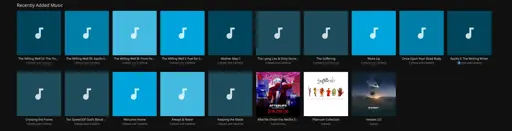

I’m trying to figure out why Jellyfin isn’t grouping this album - Good Apollo I’m Burning Star IV, Volume One: From Fear Through the Eyes of Madness - into an album, and instead showing it only as individual songs.
I’ve ensured that all of the metadata is correct, especially the artist listed and the disk number, which is just one.
I’ve also checked to see if the folder structure and naming conventions match the documentation, and they’re as listed below:
(Sorry it doesn’t list ALL the songs, but there’s a lot to type. The rest of the album match this exact file structure and naming convention)
And yet with all of these steps taken, Jellyfin still isn’t grouping this album correctly. Am I doing something wrong?
Please let me know if I can provide any log files, etc., and thank you!
