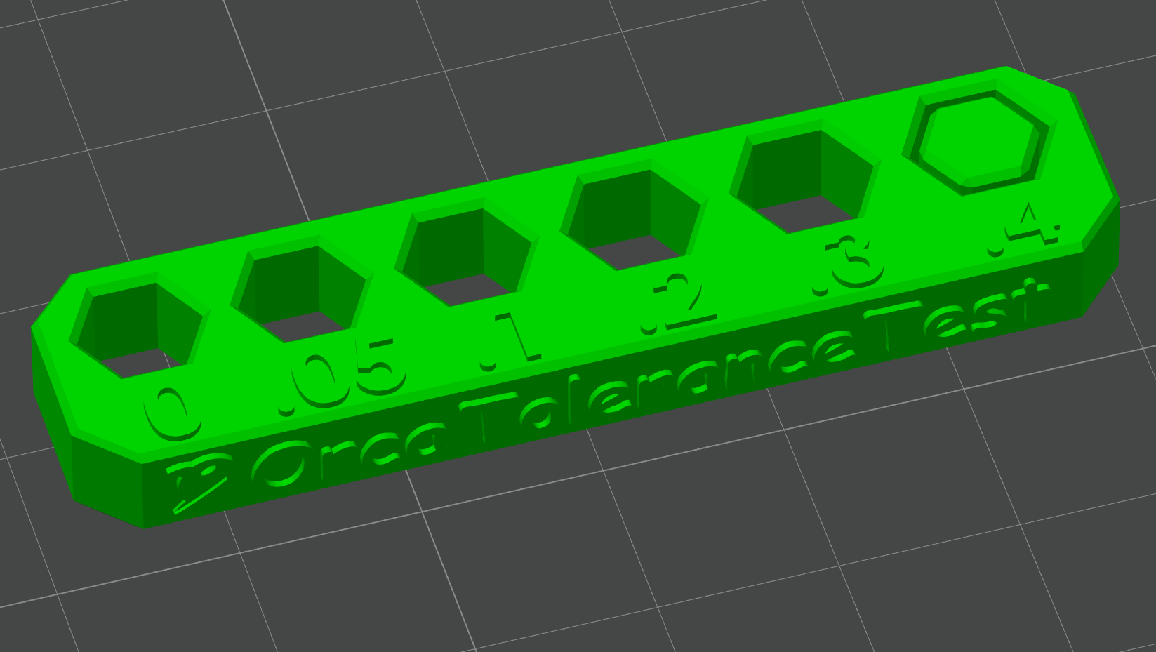

      • PhilMeGroin
        3 days ago
        Print the above tolerance test, follow the calibration help page for that print, after that test+adjust for shrinkage, which should be consistent throughout the print, and will be adjusted by a flat % across the entire stl
        • RenegadeSCOP
          2 days ago
          From the califlower test, I had a -0.1% skew. Fixed that and adjusted for shrinkage. Just printed another flashider, and it’s much better now. Tight initially, but once worked back and forth, it threads on well. I imagine a tight fit is better than a loose fit.
