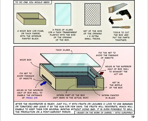

DIY Solar Dehydrator

cross-posted from: https://slrpnk.net/post/20107309
Source: Bon Bagay: Permaculture, Abundance and Autonomy (scroll to bottom)
