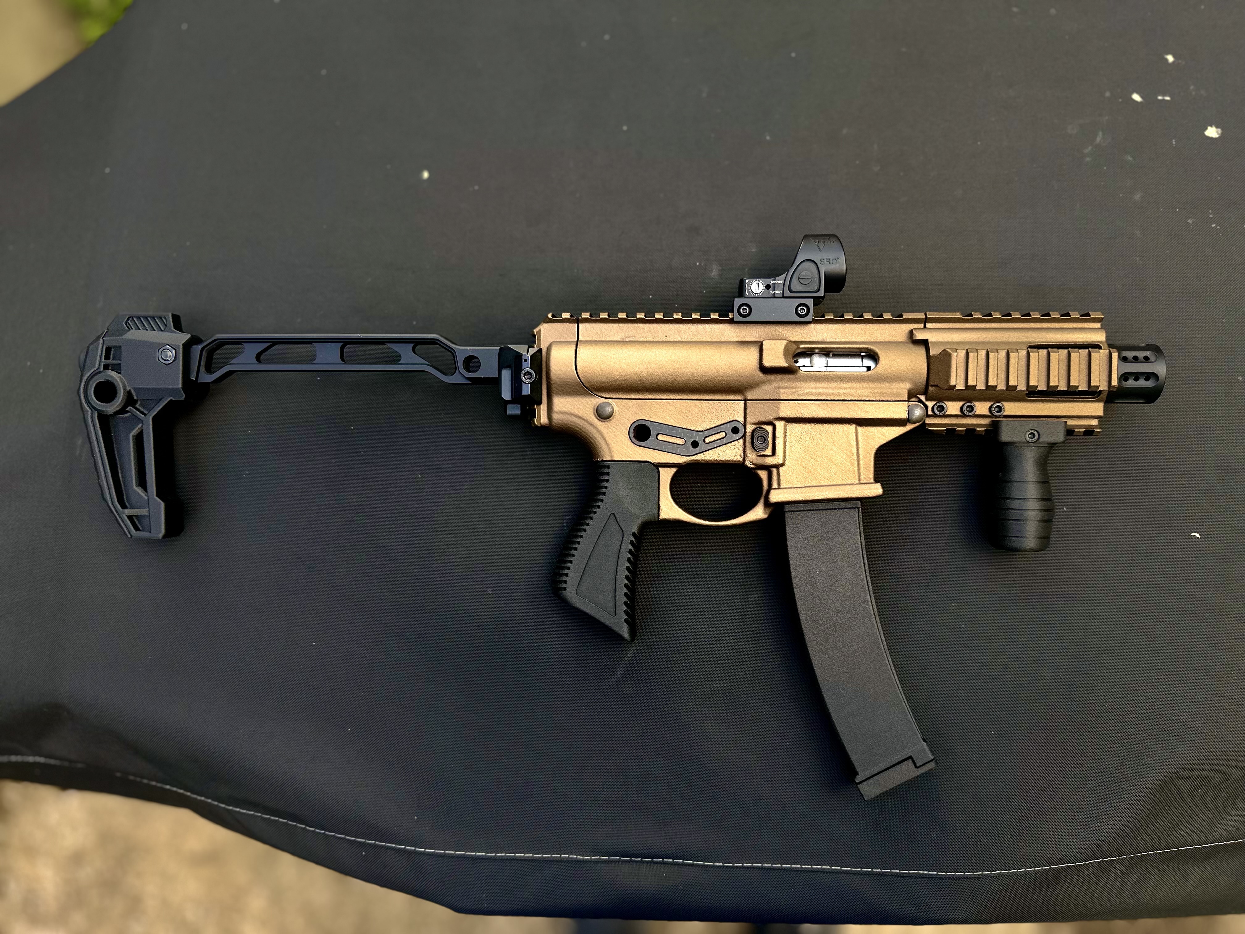

So when I run the SS Manually it doesn’t release the hammer when the upper is on, but if I have the upper off it releases. So what’s happening is when the upper is on and I fire a round it resets the trigger and if I release the trigger and pull it again it will then allow for the hammer to drop. It’s like the trip isn’t pushing the SS lever far enough forward to allow the trigger to depress and drop the hammer. Have any of you ran into this or know what’s going on? The SS works perfect in my AR’s and in my DB alloy so I know that the trigger is cut right
  • 300blkFDEOP
    1 month ago
    Ok so I have done a lot more investigating into the problem that I’m having with my deAR22 SS and it’s not when the lever comes back forward, it’s not pushing the lever back enough to release the trigger. It likes about 2mm letting it release before it goes back forward.
