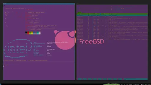

After a recent debate I had in a comment section about whether or not 2 gigs of RAM was enough for a modern workload, I started customizing to make it happen.
In my first screenshot (second in post body) you can see my specs in a neofetch and cpufetch output. I’m running a custom Kernel to bring my RAM usage as low as humanly possible while still maintaining support for all my hardware, I am on round 1 of kernel minimizing, only things I was 100% sure i didnt need have been removed. Round 2 will be removing things I might need but not frequently, I will be leaving a second kernel installed to access them.
GTK themes are listed because I have lxqt installed, I try my best not to use it though.
In my second screenshot (first in post body) you can see from left to right, top to bottom:
  1. Links with a DDG search
  2. offpunk browsing a gemlog
  3. turbo with a sample of my writing (it isn’t good, I don’t pretend to be a writer)
  4. a neofetch output
  5. discordo, called by a shell script that runs it with my bot token (self bots are against discord’s TOS, do not make them, or do idgaf its your account)
I am using the Ultima theme (https://github.com/egorlem/ultima.zsh-theme.git) for Oh-My-Zsh
Terminal frontend is Sakura but I used Terminator to customize my terminal colors as Sakura only allows you to change your Background and Foreground colors.
