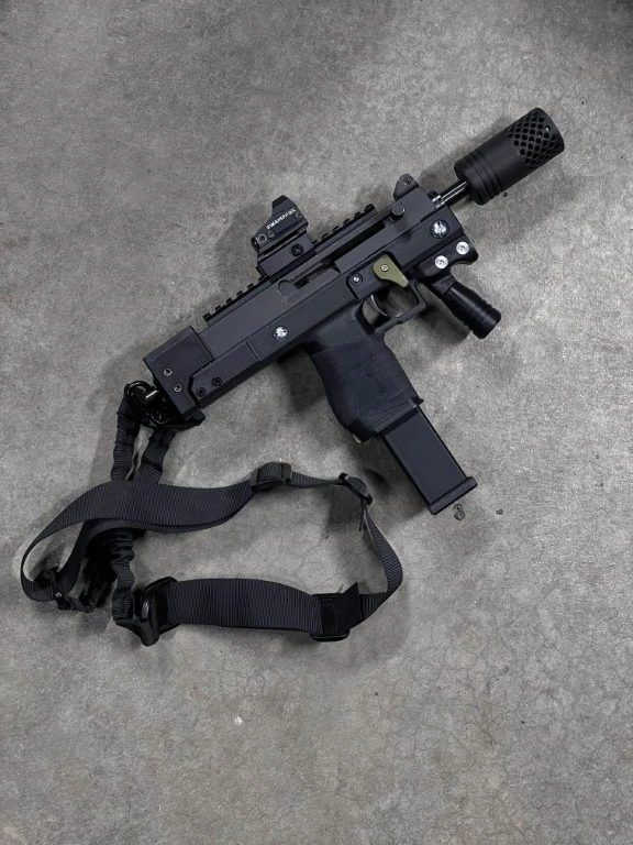

  • ill build them all.. what models are present in this pic ? i have two of these built and love them both. just wish they supported lrho.
    r3 r45
    do all these slide support a side charging handle ? how do you remove the safety to support a side ch ?
  • yeah.. this build project is coming along.. good stuff.. thanks for all your work
  • yeah... i figured that out the other day. thanks for the confirmation though.
  • re: safety tumbler.
    firured out the safety issue. the sear and trigger bar were not correctly installed.
    now need to print another charging handle. i would say plastic charging handles are not it. will have to order a metal ch.
  • seems like the safety is blocking the trigger from fully coming down thuus pushing the sear/trigger block back to disengage/disconnect the hammer. im guessing the tumbler is supposed to roll back to allow the trigger to come down far enough ? what am i missing here ? will the mpa9mm safety selector work ?
    outside of that, the build is complete.. i the meantime i can range test without the safety installed.
