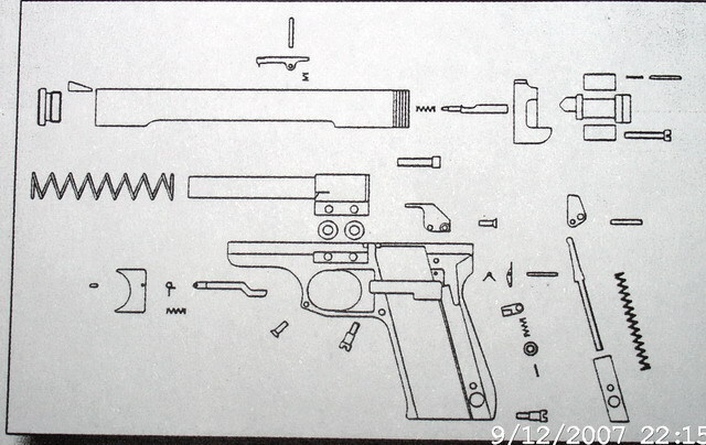

    the “only” animation on youtube is really “wrong”, because it is how really the “Musgres” works - https://guncadindex.com/detail/musgres_v2:e . The guy on youtube animated a old version of Musgres and posted it as “Musgrave”.

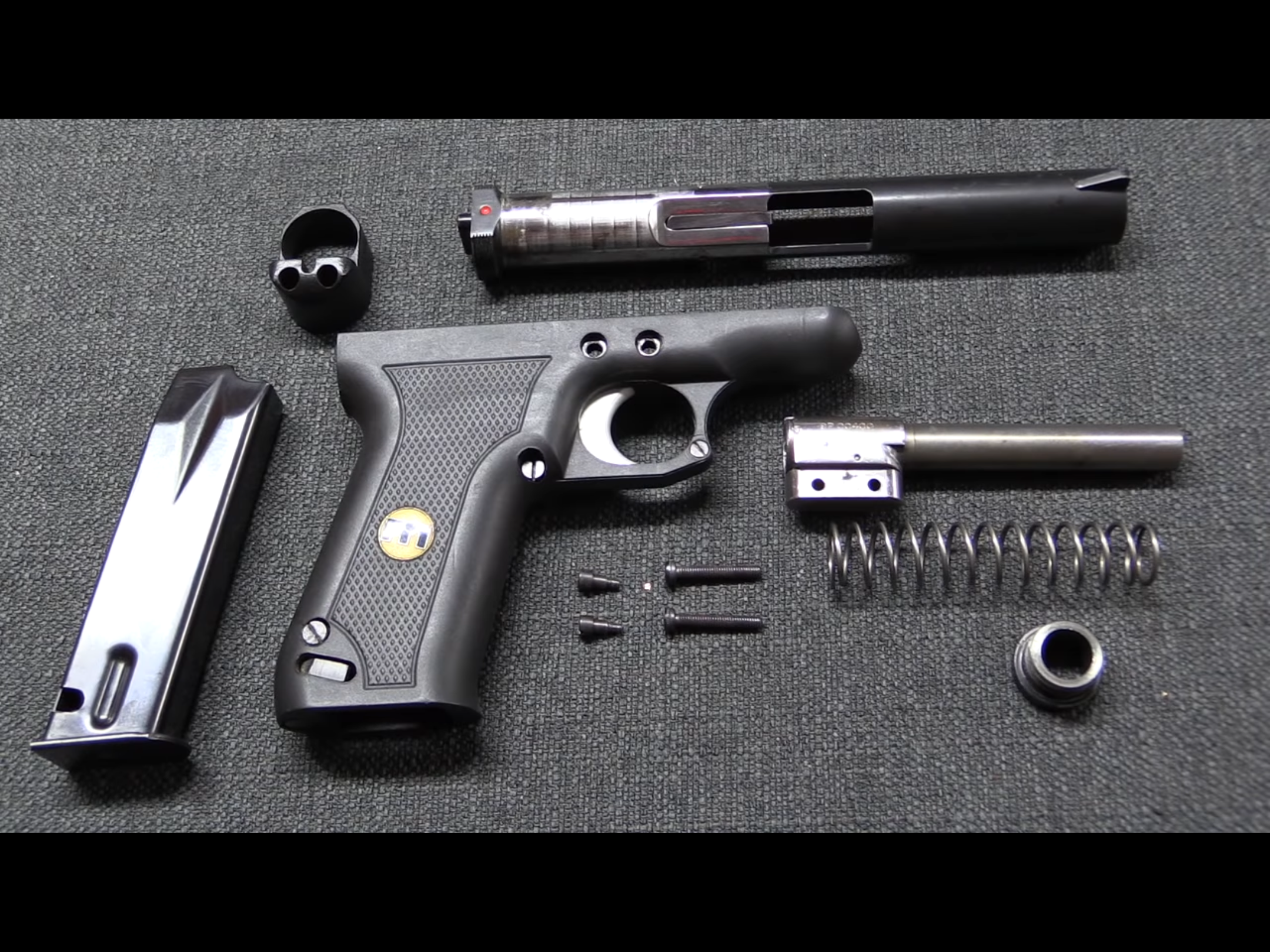

      No offense intended, and that explains it. I hadn’t watched that animation but I remembered thinking “this isn’t accurate to the actual pistol” because of the sights, extractor is different, the Glock mag, the extra pins, etc. I really wish gun Jesus had actually opened up the frame.
      • Martin
        3 days ago
        thats the only available source of the Musgave inner

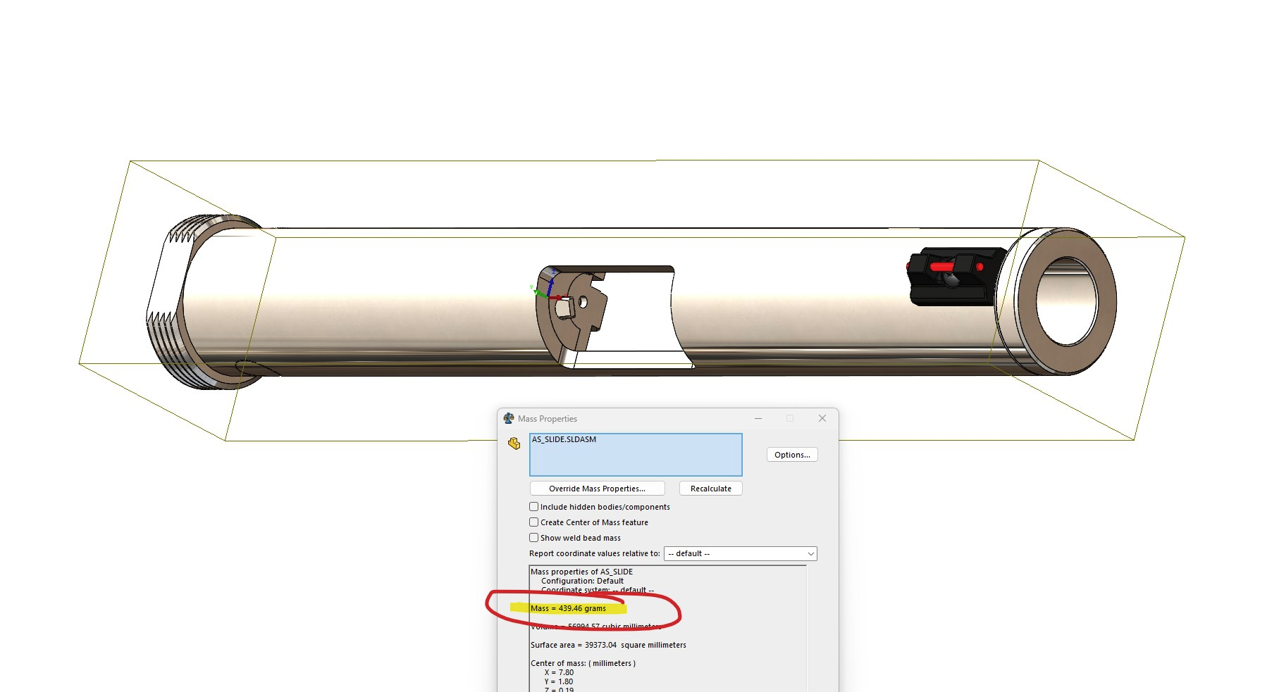

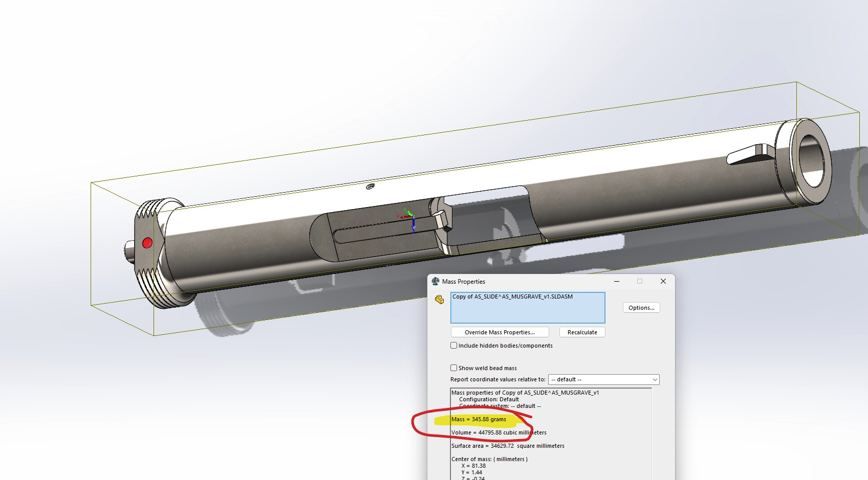

            No offense - but you’ll not make any updates on this construction “soon” … that’s Musgrave slide with ~350g. weight:
            and that’s Musgres slide with 1" tube and ~440g. slide :
            and trust me - the cad weight calculations are pretty correct.
