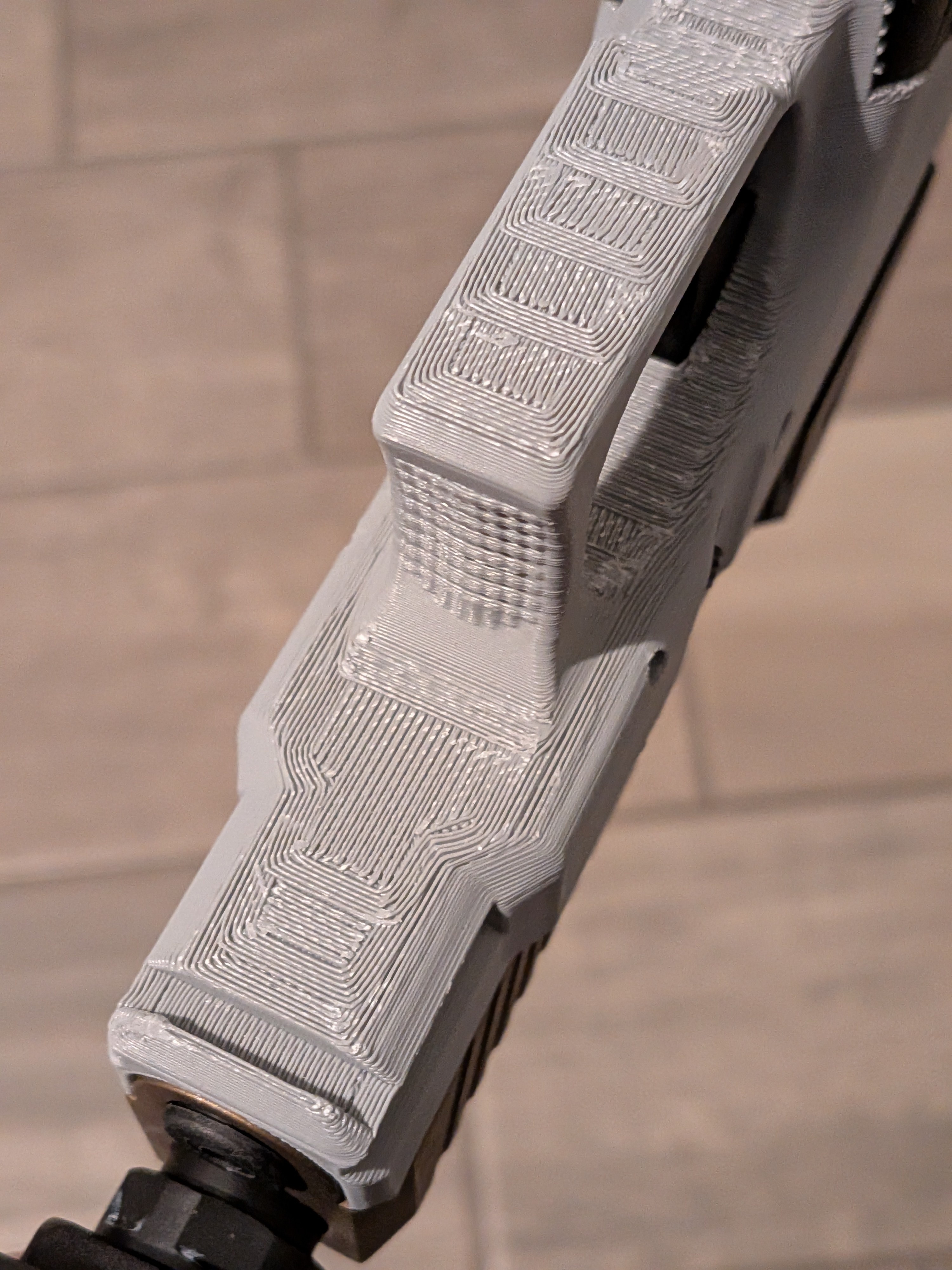

    But you really don’t need to do multi-material to get clean support removal. Tune your support settings and your cooling and you can get clean support removal without wasting a bunch of time and material. Here’s one I printed a few days ago, rails-up, in 3D Fuel Tough Pro PLA+.
    I didn’t do any clean-up other than just removing the supports. I could have probably gotten it even cleaner if I slowed the print down a bit, but this was only intended as a test mule.
    • unexpected
      19 days ago
      Looks pretty good, but to be fair, 100% full supports looks a lot better. Always worth doing when you got an IDEX. I don’t know about those material changing printers though. Looks like a lot of waste in material and time. Would definitely have me thinking twice.
